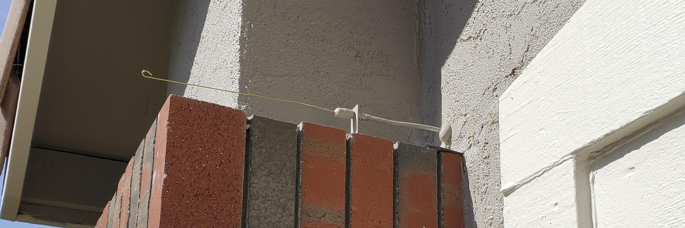

- Buy a garage door antenna extender. Available on amazon for about 30 bucks and is really neat if it extends the range of your garage door opener half way down the block. I put mine outside of the garage thru the wall shown in the second photo. The antenna connects to the garage door opener antenna using an RG6 female female connector shown above the letters Ma in the first photo.
