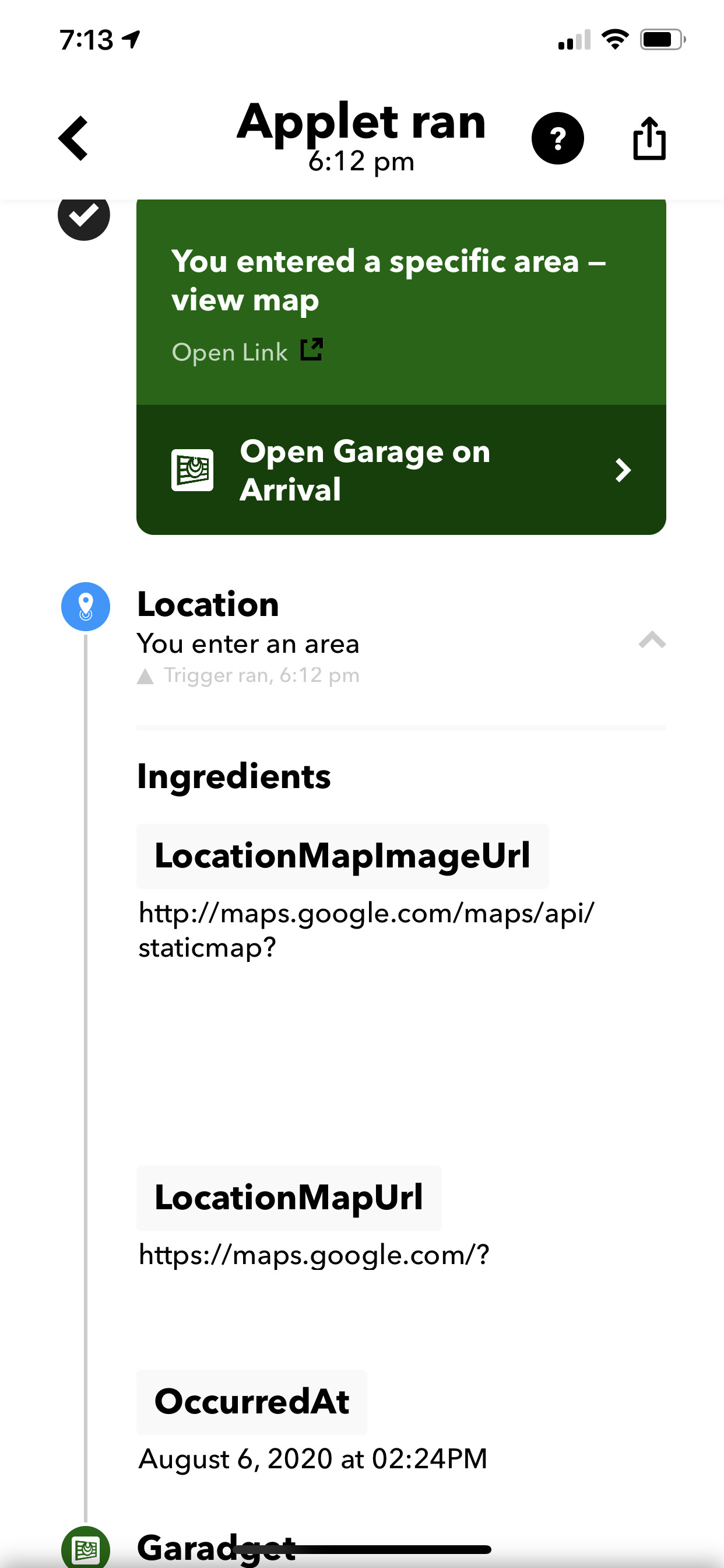

My applet ran 4 hours later. The garage door did not open upon my arrival at home (2:24pm). It ran 4 hours later while I was taking a nap (6:12pm). I only realized the garage door was open after checking my phone alerts that the door open applet ran at 6:12pm. Any ideas. Thanks.
So IFTTT is not perfect and I have had this happen before. It’s never taken this long, but it has been several minutes after I got home. I believe it’s due to the fact that IFTTT didn’t pickup my location quickly from my phone and once it finally did (many minutes later) it immediately triggered the open action.
My only suggestion, assuming your door opens all the time as expected, is to just open the Garadget app if you come home and it doesn’t open on it’s own. This usually syncs up my location (of my phone) with both IFTTT and the Garadget app.
Geo-fencing trigger in IFTTT’s app relies on location data from the phone.
Mobile operation system may act economical when it comes to running location services to preserve the battery. You can tip the balance in the direction of more location accuracy.
