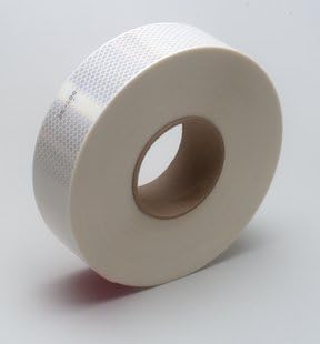

Will this work??
I used a fairly long strip of clear packing tape covering the reflective strip to help keep it in place. My reflective is staying in place and it’s reflecting the light through the tape.

You need Reflective Tape that passes the ASTM standard for Type IV High-Intensity Grade Reflective Surfaces. It is identical to the disks that come with Garadget. I found it on Amazon, but it is not in stock right now. Search for Type IV reflective tape. Much of the cheaper tape is Type I, engineering grade, and was not adequate.
