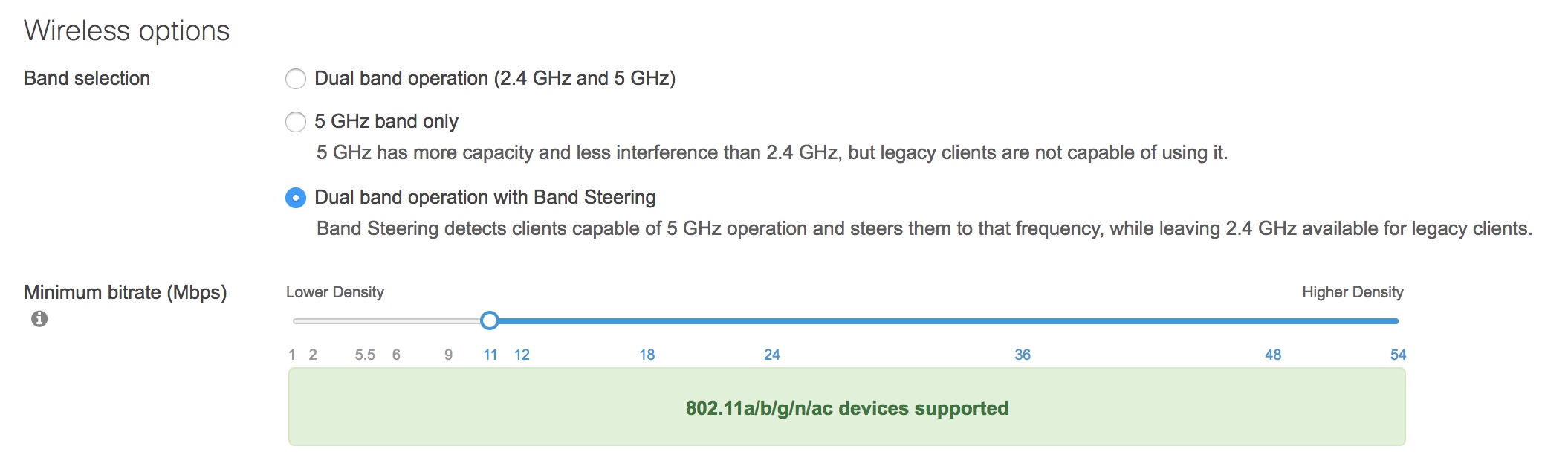

Hi, Just an update, I think the issue either lies with my Note 8 (Smart WiFi Switching) or Meraki MR33. I grabbed my iPhone and tried setting the Garadget back up. It got further and allowed me to see AP’s, however I couldn’t see my main AP. I rebooted my AP (even though it appeared to be working fine). There was no difference, so I ended up reducing the density from 24mbit down to 1. I rebooted the Garadget and I could see the SSID. It actually just connected back to it without setting it back up.
I then put the density of my AP back up to 11mbit and I still have a connection.
Even though the npm install of particle-cli didn’t work, I am back up and running!
