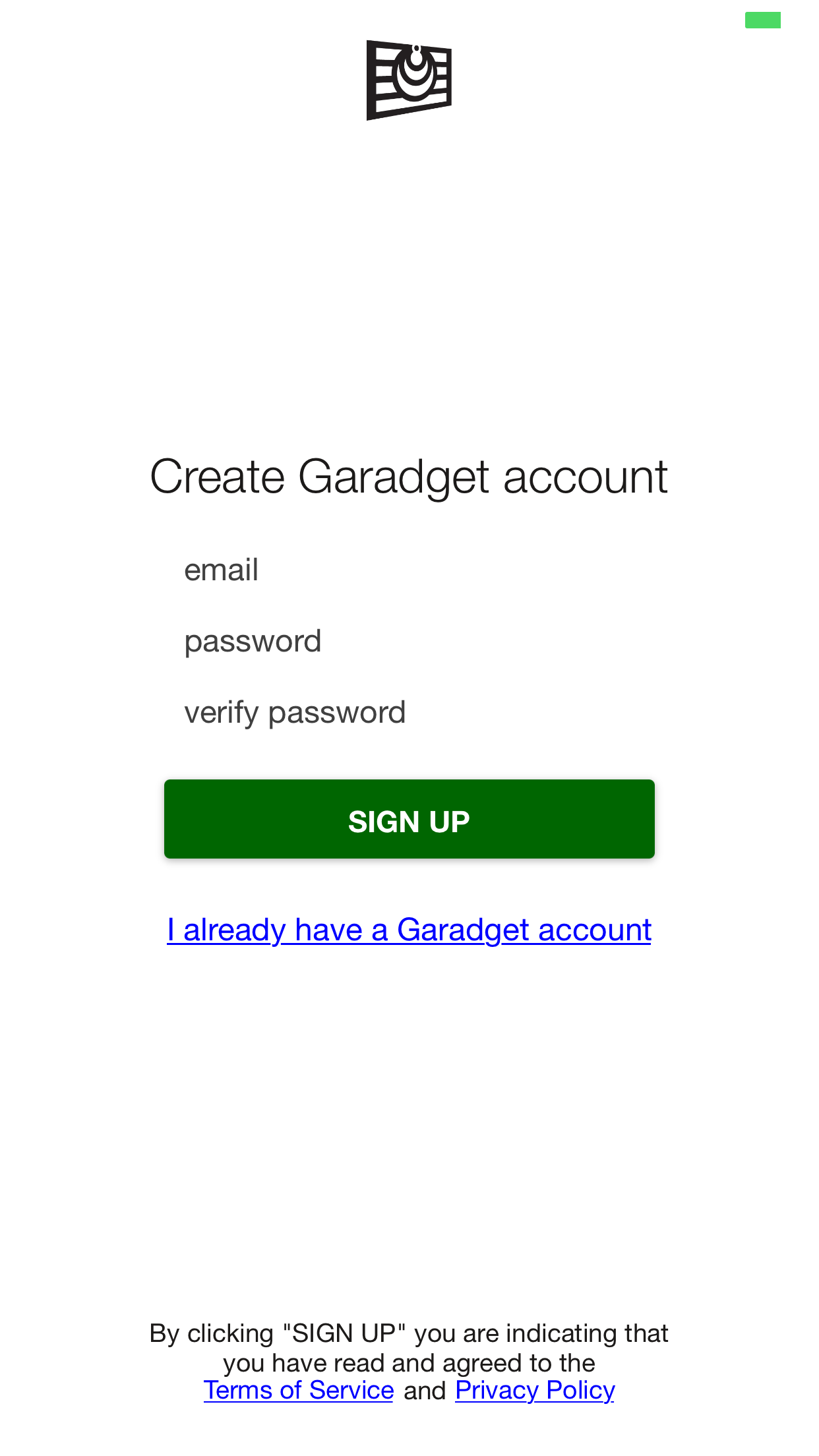

Also when using this portion of the app, if I try to upload a picture the app crashes.
Here is the picture that I was trying to upload. Each time I open the app I get an error message then this screen appears asking me if I want to create a new account.
I’m also being asked to login every time I open the beta app.
Click on the garadget logo in the top left and make sure “authenticate” is unchecked. If you switch it on, you’ll need to logon to garadget when you open the app. It will accept Touch ID but seems a bit OTT unless you are using an unlocked IOS device.
