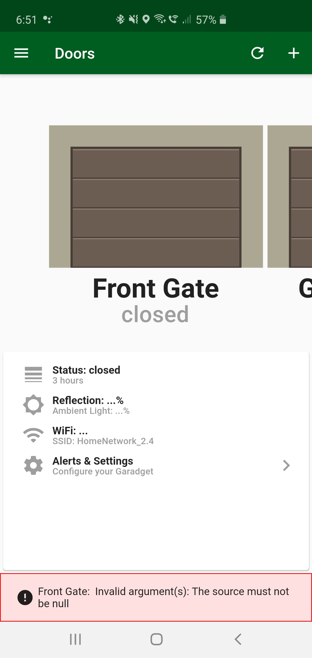

When opening the app however I receive the enclosed message on my front gate. If you remember Denis we disabled the laser on this device & I installed the contact switch. Unsure if that is related?
Cheers Denis
Paul,
It looks like it has to do with the reflection not being reported as expected because your unit doesn’t use it. I’ll look into fortifying that part of code in the next release.

I have v2.0.1+5 Denis - all errors have gone and no invalid arguements
