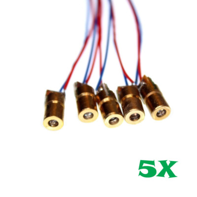

I think I need to now replace the laser on one of my units. I was able to get along by lowering the threshold, but now it’s set to 3% and I’m still having false alerts. Will these lasers work as a replacement?
If not could you share a link for the correct laser?
Thank you!
Aaron
This should work, but before going this route please try swapping out the power supply in case that is the reason for the degraded laser brightness. Any USB charger will work for this purpose.
